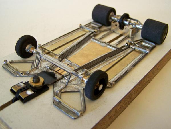

Photo 18 of 64 from Hitchhiker’s Guide to CMF3 Scratchbuild Chassis
1305-C
Ret-ro rules in-line, adaptation of 1219 framing pattern using the sectional movement of the 1218; all wire frame, with 0.010” brass sheet backed with 0.039” wire inner side pans and wire outer torsional side “pans”, and a separate center-guide section with torsional inner sections (wire version of “H” cut) made of 0.010” brass sheet backed with 0.039” wire.
